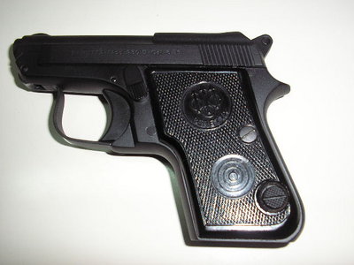

II rad; Beretta M-950B u ''matte-black''
- Beretta M-950B
Re: DuraCoat project
Posted: 21 Feb 2012, 19:17
by Deki
Zarazio si me tim duracoatom,,,svaka cast predobro izgleda!
