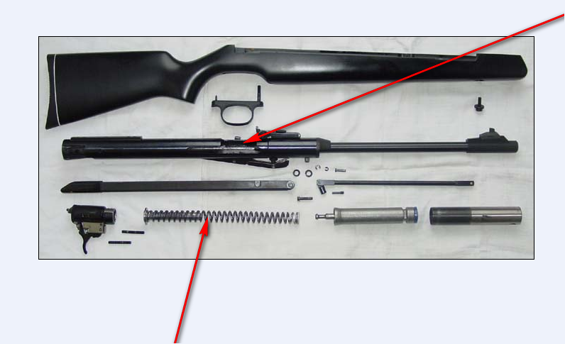

nuklearka
Posts: 2
Joined: 03 Jul 2009, 19:21
Location: Slavonski Brod
Re: Podmazivanje zračnice
Post by nuklearka » 05 Jul 2009, 09:04
Mast stavljam (slika)
