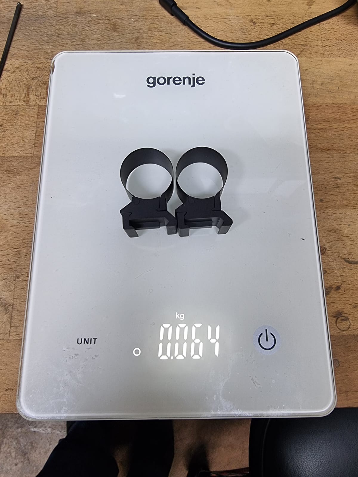

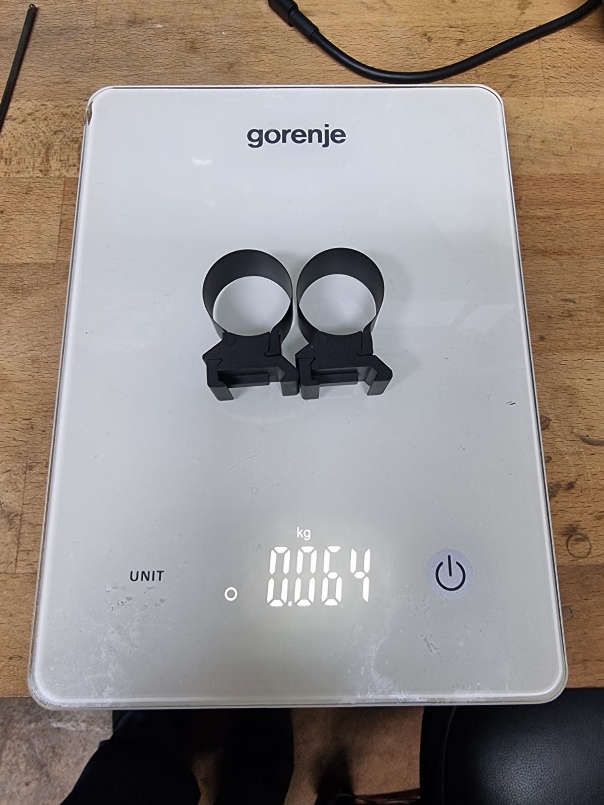

NIGHTFORCE COMPETITION 15-55x52 FCR-1 (790 grama)
March ghost ringovi (visina 11 mm-težina 64gr)
Ukoliko treba dvije, tri rupe u kundaku...

Post by stolttom » 22 Jan 2024, 23:24
March ghost

stolttom wrote:March ghost
vjerovatno taljanski dinpal?
Ne. March Ghost!!
