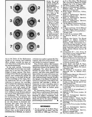

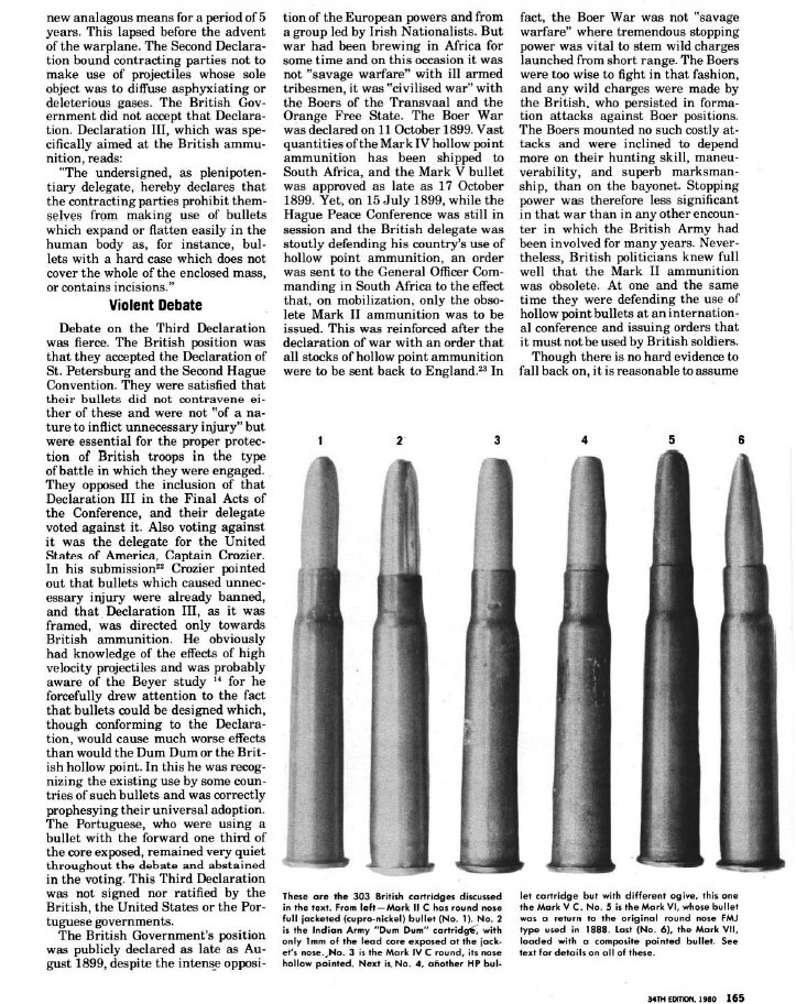

Post by jolly » 20 Jan 2021, 03:54
Posts: 7749
Has thanked: 7 times
Been thanked: 13 times
Re: 303 ENFIELD, DUM DUM METAK, HASKA KONVENCIJA
Post by jolly » 20 Jan 2021, 03:55
Posts: 7749
Post by jolly » 20 Jan 2021, 03:56
